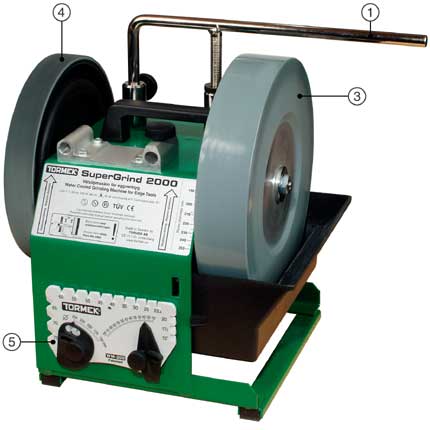

For Christmas I bought a Tormek and until now, I had no idea what sharp was. I sharpened just about every hand tool, and of course had to test each one as I finished it to see if it would shave hair, thus the backs of both hands are hairless along with a bunch of cuts I wouldn't have had before.
I was trying to decide between the Tormek and Veritas Mark II. system. As it turns out, I was at Woodcraft yesterday and they were giving away a $60 shop light with the Tormek. My willpower was not very strong as my wife had already cut off our chocolate for the new year, so the Tormek had to come home with me.
The Tormek is very easy to use, and until now I've never had tools this sharp. I had no idea blades could be so dull and un-true right out of the box. It's AMAZING how much better my plane works with a sharp blade. I actually thicknessed one of Jasons 6+ mm cedar tops in about 5 minutes. I'm extrmely happy with the results, but more so in the sense that I think I realized I can thickness tops/backs by hand and no longer need a thickness sander for the 2-3 guitars I'll build this year. Previously the results were poor and I always got tearout and chattering. I also love the fact that in under 5 minutes I was able to change and fine tune the bevels on all my chisels. What a difference the bevels make!
Bottom line, if you're a small-time hobby builder like me, it's easy to under-estimate the importance of sharp tools and return of investment on a good sharpening system. It took me 2+ years to break down and buy one. This should have been one of my earlier purchases and it would have saved me a lot of time and trouble during the build process. If you're on the fence about getting one, don't hesitate, get some type of sharpening system. Make it your new years resolution.

Hi JJ,
I always used the stones and wet sandpaper to sharpen the tools in the past. I always thought they were decent and that I just didn't use the tools well, or they weren't the best choice for the job. I think the Tormek finally showed me what they should be like, and then my skills improved dramatically using sharp tools. If you're ever in the area, bring your tools and try it out.
Cheers!
PostPosted: Sat Jan 07, 2006 2:47 pm
Posts: 993
Check out tormek.com.
Here's a pic:
PostPosted: Sun Jan 08, 2006 11:46 pm
   WOW! Now that looks serious! I'll bet it's a lot more fun to use than my cheap guide from Home Depot!!!
